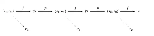

The situation is illustrated by the following diagram
So, here, $P$ is the stochastic transition function (i.e. a probability distribution) as used above. Note that, here, $r_t$ is a specific realization of $R_t$ (the random variable) in the formulas below.
