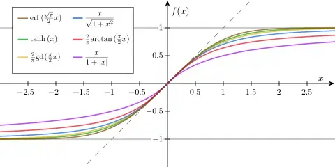

  • activation functions fine-tuning (for example shift and slope of sigmoid) types of sigmoid finetuning
