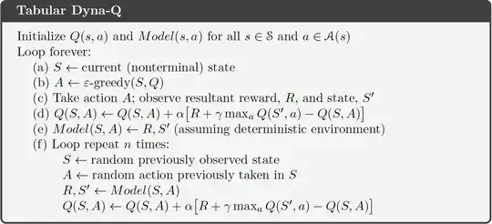

A reinforcement learning algorithm is considered model based if it uses estimates of the environments dynamics to help learn. For instance, in the Tabular Dyna-Q algorithm, every time you visit a state action tuple you store in a look-up table the reward received and the next state transitioned to, and after every execution of an action you loop $n$ times to further back up your $Q$ table using these stored model values from the look-up table. I will attach a copy of the pseudo-code for an algorithm at the bottom of this post.
Algorithms like vanilla $Q$-learning are model free because they don't require a model of the environment to learn.

  • This answer is correct and I would upvote it, but if this question is a duplicate of this one, I think it's better you answer there (although there are already many answers there, but none of them mentions Dyna-Q, apparently), because this will probably be closed as a duplicate of that one (I am just waiting for the OP's feedback). – nbro Sep 25 '20 at 21:30
