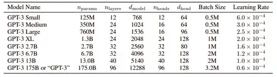

When I studied neural networks, parameters were learning rate, batch size etc. But even GPT3's ArXiv paper does not mention anything about what exactly the parameters are, but gives a small hint that they might just be sentences.
Even tutorial sites like this one start talking about the usual parameters, but also say "model_name: This indicates which model we are using. In our case, we are using the GPT-2 model with 345 million parameters or weights". So are the 175 billion "parameters" just neural weights? Why then are they called parameters? GPT3's paper shows that there are only 96 layers, so I'm assuming it's not a very deep network, but extremely fat. Or does it mean that each "parameter" is just a representation of the encoders or decoders?

    Parameters is a synonym for weights, which are what you learn. Batch size, learning rate etc are typically hyper parameters – David Jul 26 '20 at 19:39
  • Thank you David. So now my understanding is that GPT3 has 96 layers and 175 billion nodes (weights or parameters) arranged in various ways as part of the transformer model. – Nav Jul 27 '20 at 02:35
    It won’t have 175million nodes, if you think of a simpler neural network then the number of parameters is how many connections there are between nodes. If there was a NN with 1 layer of 2 neurons followed by a layer with 3 neurons, then an output layer with 1 neuron there would be 9 parameters (you could draw this out to see what I mean). – David Jul 27 '20 at 08:48
    Understood. The weights are vectors which are called the "learned parameters". Thank you very much, David. If you post it as an answer, I'll accept it. Hopefully, this would be of help to anyone else searching for this answer. – Nav Jul 28 '20 at 05:40
    Note that @DavidIreland is assuming a fully connected NN for 9 parameters – Jordan Morris Mar 20 '23 at 09:05
    and no biases, if you’re being pedantic @JordanMorris – David Mar 22 '23 at 01:04

Parameters is a synonym for weights, which is the term most people use for a neural networks parameters (and indeed in my experience it is a term that machine learners will use in general whereas parameters is more often found in statistics literature). Batch size, learning rate etc. are hyper-parameters which basically means they are user specified, whereas weights are what the learning algorithm will learn through training.
