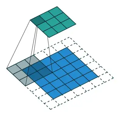

Here's an illustrative example of how the convolution works.
where the $\color{blue}{\text{blue}}$ grid is the image, the $\color{gray}{\text{gray}}$ grid is the kernel and $\color{green}{\text{green}}$ grid is the feature map (i.e. the output of the convolution between the image and the kernel). The white squares are around the images represent the padding that is added around the image so that the convolution operation produces a feature map of a specific dimension.
Essentially, the convolution is a series of dot products between the kernel and different patches (or parts) of the image. The convolution can even be represented as matrix multiplication, so the name convolution shouldn't scare you anymore, if you are familiar with dot products and matrix multiplications.
