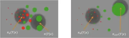

Let's fix some notation: we're collecting data from behavior policy $\pi_0$ and we want to evaluate a policy $\pi$. Of course, if we had plenty of data from policy $\pi$ that would be the best way to evaluate $\pi$ as we just take the empirical average (without any importance sampling) and CLT gives us confidence intervals that shrink at $\frac{1}{\sqrt n}$ rates.
However, collecting data from $\pi$ is often time-consuming and costly: you may need to productionize it at a company, and if $\pi$ were dangerous, some damage could be done during rollouts. So how can we make the best use of our data from any policies, not necessarily $\pi$, to evaluate $\pi$? This is the question of off-policy evaluation, and you're right that IS is one approach.
This picture from a great talk by Thorsten provides nice intuition on why the weighting is unbiased enter image description here.
