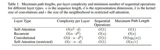

arxiv:1706.03762 table is from arxiv:1706.03762 Attention Is All You Need
It's because of the path length. If you have a sequence of length n. Then a transformer will have access to each element with O(1) sequential operations where a recurrent neural network will need at most O(n) sequential operations to access an element.
Very long sequences gives you problem with exploding and vanishing gradients because of the chain rule in backprop.
Transformers don't have this problem as the distance to each element in the sequence is always O(1) sequential operations away. (as it selects the right element instead of trying to "remember" it)
(arxiv:2103.05487) UnICORNN: A recurrent model for learning very long time dependencies
"The design of RNNs that can accurately handle sequential inputs with long-time dependencies is very challenging.
This is largely on account of the exploding and vanishing gradient problem (EVGP)."
