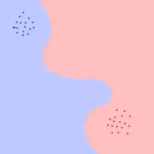

I'm an amateur with neural networks, but I will illustrate my understanding of how this problem comes to be.

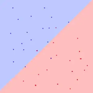

First, lets see how trivial neural network classifies 2D input into two classes : enter image description here

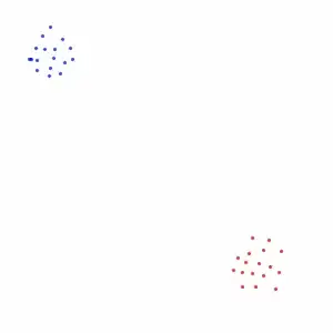

But in case of complex neural network, the input space is much bigger and the sample data points are much more clustered with big chunks of empty space between them:
The neural network then doesn't know how to classify the data in the empty space, so something like this is possible :
When using the traditional ways of measuring quality of neural networks, both of these will be considered good. As they do classify the classes themselves correctly.

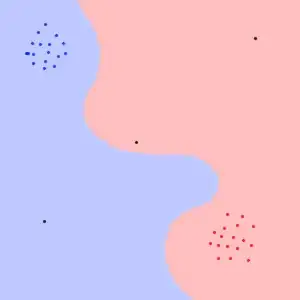

Then, what happens if we try to classify these data points?
Really, neural network has no data it could fall back on, so it just outputs what seems to us as random nonsense.
