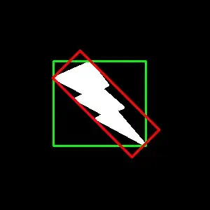

You can use OpenCV's cv2.minAreaRect() to detect oriented/rotated rectangular bounding boxes. Below's an example result from OpenCV-Python-tutorials:
Using cv2.minAreaRect()
Alternatively, you could train a supervised object detection model to output 8 co-ordinate values (x0,y0,x1,y1,x2,y2,x3,y3) of the quadrilateral by training with a labeled oriented-bounding-box dataset. You could also create the bounding box labels yourself for the same by using tools such as VGG Annotator Tool among others.
