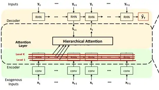

EDIT: I took some time reading the paper. I think "semantic levels" refers here to the different neural networks layers used for the exogenous features.
Here is a modified version of their figure I've drawned to make it clearer: enter image description here
In particular, from what I have understood so far, the attention coefficients apply to the whole semantic level (which I find not really clearly indicated on their figure)
The LHS of their figure would then be better described by this new one:

  • @nbro You're right, I read the question too fast. I took some time reading the paper. I think "semantic levels" refers to the possible interactions between the different layers of the neural network. Each layer of the neural network representing possibly a semantic level. The architecture of the RHN seems (does it?) to enable such direct interactions (cf. RHS of fig. 2 page 3 of the paper). Not too sure about this, I'm thrilled to see other's replies as I find the subject really interesting! :-) – Jeanba Nov 18 '19 at 15:01
  • You should edit your answer to include any new details you think are relevant to the question. Comments are only temporary and can be deleted later. – nbro Nov 18 '19 at 17:05
  • In the paper the authors mention that the first time they use RHN is to summarize the exogenous data into different semantics at different levels. So now, whit what @Jenba have said, I understand that the term "semantic levels" refers to the layers RHN shown below in fig. 2 at the bottom in green. Each layer is a different semantic tha is in a different level. – MikelBa Nov 19 '19 at 08:54
  • Yes I think we finally figured this out. I modified my original response with two new drawings to make it clearer. :-) – Jeanba Nov 19 '19 at 09:57
