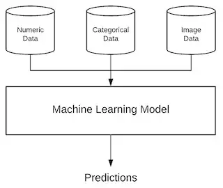

You can try using a multi-input model. Here is a recent post with a similar discussion, with the required architecture defined in the answer.
Instead of combining the separate models, you can create a model which uses image and numerical data side by side. Keras allows you to use different types of data using multi input structure via functional API. And then you can combine them to create a single machine learning model. Basic idea is like this:
this
This image was taken from here, where you can find further details and the code implementation as well. Actually, the discussion in the introduction of that post is almost the same as your question: What to do when the inputs are:
  • Numeric/continuous values, such as age, heart rate, blood pressure
  • Categorical values, including gender and ethnicity
  • Image data, such as any MRI, X-ray, etc.
Also, section 5.1 of this blogpost details the same process.

  • Can you argue/elaborate why a multi-input model would be useful in this case? – nbro Nov 13 '19 at 12:55
  • Is this case much different from the one I provided the link above, except for the use of SVC instead of a dense model? It is a valid way to combine different input types, and can be achieved using Keras. Whether it will improve the accuracy or not is subject to experiment. – serali Nov 13 '19 at 13:07
  • I've not read the other post, but I think you should at least argue in this question why the solution given in another place may be useful. – nbro Nov 13 '19 at 15:05
