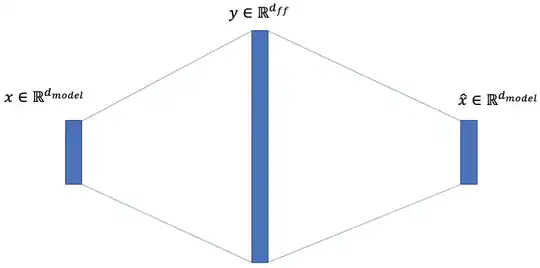

I'm going to post another guess to this question - it won't be a complete answer, but hopefully it'll provide some direction towards finding a more legitimate answer.
The feed-forward networks as suggested by Vaswani are very reminiscent of the sparse autoencoders. Where the input / output dimensions are much greater than the hidden input dimension.
If you aren't familiar with sparse autoencoders, this is a little counter intuitive - WTF would you have a larger hidden dimension?
The intuition borrows from infinitely wide neural networks. If you have an infinitely wide neural network, you have basically have a Gaussian process and sample any function you'd like. So the wider the network you have, the more approximation power that you have. In the case of inputs, this is a matter of learning a dictionary. If you have only discrete inputs, this hidden layer will be capped at $O(2^N)$ width, where $N$ is the maximum number of bits it takes to represent the input (which would boil down to approximating a lookup table).
Of course, these aren't trivial to implement in practice. These layers are bound to be bloated with identifiability issues. Common approaches include $L_1$ regularization. I'm guessing that the convolutional layers + dropout are just another attempt to deal with these sorts of identifiability issues. Furthermore, the FFN is an attempt to learn an arbitrary mapping for individual words (you can think of mapping words to synonyms for instance).
These are all guesses though - more intuition is welcome.

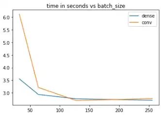

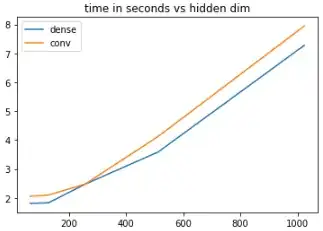

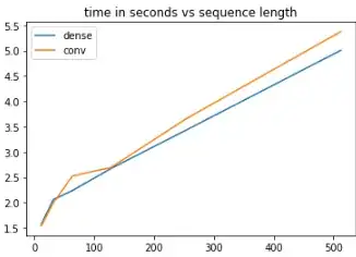

Regarding bench-marking the 2, your experiment was shallow. I didn't have time to wait to do a full gird search, so i held 3 paramaters constant and fluctuated one. Here are the results (note the model was just a simple feed forward relu residual model)
enter image description here enter image description here enter image description here enter image description here
Note that in a couple yeah dense out performs conv but it isn't consistent and there are scenarios where it is not true. This is only for a small grid that I chose but you can extend this yourself to check. So it is not as straightforward to say one is sheerly better than the other.
mshlis
  • 2,359
  • 23
  • I have benchmarked performance on various input sizes and a simple Dense implementation seems to win all the time with respect to speed. It's very hard to benchmark memory consumption in Tensorflow, because it is not exactly deterministic, but I don't see any possible optimisations here either. By the way, your sidenote has already been written in the question. – Eli Korvigo Feb 07 '20 at 15:13
  • @Eli 1) Hmm I cant imagine that being true for large models. What models were the benchmarks on. 2) whoops, i gotta read more lol – mshlis Feb 07 '20 at 15:54
  • I've added some benchmarks to my question – Eli Korvigo Feb 12 '20 at 20:14
  • @EliKorvigo I just ran a couple benchmarks that extend past just a single run – mshlis Feb 12 '20 at 21:30
