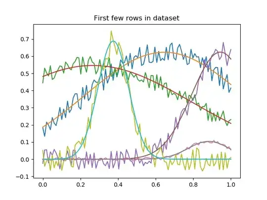

Here's an example generating the kind of data I'm talking about:
import numpy as np
Nr = 2000
Nx = 100
x = np.linspace(0,1,Nx)
f1 = lambda x, a, b, c : a*np.exp( -(x-b)**2/c**2) # An example function
f2 = lambda x, a, b, c : a*np.sin( x*b + c)        # Another example function
prange1 = np.array([[0,1],[0,1],[0,.5]])
prange2 = np.array([[0,1],[0,Nx/2.0],[0,np.pi*2]])
#f, prange = f1, prange1
f, prange = f2, prange2
data = np.zeros((Nr,Nx))
parms = np.zeros((Nr,3))
for i in range(Nr) :
    a,b,c = np.random.rand(3)*(prange[:,1]-prange[:,0])+prange[:,0]
    parms[i] = a,b,c
    data[i] = f(x,a,b,c) + (np.random.rand(Nx)-.5)*.2*a
plt.figure(1)
plt.clf()
for i in range(3) :
    plt.title('First few rows in dataset')
    plt.plot(x,data[i],'.')
    plt.plot(x,f(x,*parms[i]))
Given data, could you train a model on half the data set, and then determine the a,b,c values from the other half?

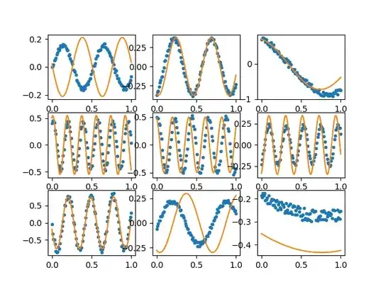

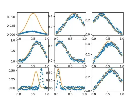

While John's answer I think gives a better idea of which direction I might want to go to seriously tackle this, it turns out that just throwing the data straight into some sklearn algorithms does work better than I thought it would. For example, the following produces ballpark results for the model parameters (for the two model cases I tested), without assuming (explicitly) anything about the model itself:
from sklearn.ensemble import RandomForestRegressor
from sklearn.model_selection import train_test_split
from sklearn import metrics
Xtrain, Xtest, ytrain, ytest = train_test_split(data, parms, random_state=1, )
model = RandomForestRegressor(random_state=1, n_estimators=15, n_jobs=7)
model.fit(X=Xtrain,y=ytrain)
ypred = model.predict(Xtest)
print(f'i={i} ' + str([metrics.explained_variance_score(ytest[:,i], ypred[:,i]) for i in [0,1,2]]))
plt.figure(2)
plt.title('Guessed parameter fits')
plt.clf()
for i in range(3) :
    for j in range(3) :
        plt.subplot(3,3,i*3+j+1)
        plt.plot(x,Xtest[i*3+j],'.')
        plt.plot(x,f(x,*ypred[i*3+j,:]))
plt.show()
Results
Gaussian curves, explained variance for a,b,c parameter guesses (1.0=perfect everytime):
[0.8784556933371098, 0.9172501716286985, 0.8874106964444304]
Sin curves, explained variance for a,b,c parameter guesses
[0.8190156553698631, 0.9757765139100565, 0.7551784827108721]
Here's some plots of from the test sets, along with the original model evaluated with the guessed parameters.
Example plots Example plots
