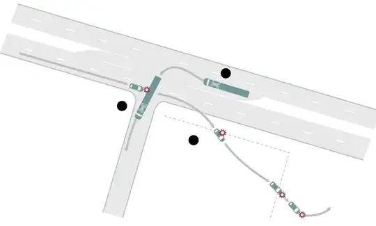

So basically what is known is that the accident involved the side of a truck trailer (of a large white 18-wheel truck) and most likely the camera had a washed out of picture possibly due to glare or blooming from overexposure which made that the side of the trailer white and thin which failed to distinguish with the sky which was bright as well.
This may have happened in part, because the crash-avoidance system only engage when both radar and vision system detect an obstacle which could not happen.
Further more it was suggested by The Associated Press that the driver most likely was watching a Harry Potter at the time of the crash and assuming system would alert Brown, we don't know if he was able to retake controls quickly enough to avoid impact. As mentioned again, the system wasn't intended for hands-free driving and parts of the system was unfinished. Not to mention that the car was driving with full speed under the trailer.
Tesla officially said about this crash in a statement on its website:
The high ride height of the trailer combined with its positioning across the road and the extremely rare circumstances of the impact caused the Model S to pass under the trailer, with the bottom of the trailer impacting the windshield of the Model S.
Neither Autopilot nor the driver noticed the white side of the tractor-trailer against a brightly lit sky, so the brake was not applied.
They also said, according to techno-optimists, that they will tweaks their code, so this particular case won't happen again.
To summarize, this was a 'technical failure' of braking system and most likely Autopilot was not at as Tesla told Senate.
The New York Times |Source: Florida traffic crash report
