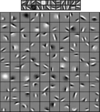

The second common strategy is to visualize the weights (filters). These are usually most interpretable on the first CONV layer which is looking directly at the raw pixel data, but it is possible to also show the filter weights deeper in the network. For example, the first layer usually learns gabor-like filters that basically detect edges and blobs.
first layer filters

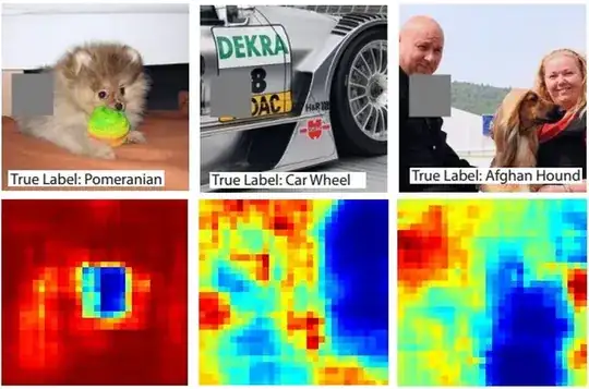

Occlusion experiments
Here's the idea. Suppose that a ConvNet classifies an image as a dog. How can we be certain that it’s actually picking up on the dog in the image as opposed to some contextual cues from the background or some other miscellaneous object?
One way of investigating which part of the image some classification prediction is coming from is by plotting the probability of the class of interest (e.g. dog class) as a function of the position of an occluder object. If we iterate over regions of the image, replace it with all zeros and check the classification result, we can build a 2-dimensional heat map of what's most important for the network on a particular image. This approach has been used in Matthew Zeiler’s Visualizing and Understanding Convolutional Networks (that you refer to in your question):
occlusion experiments

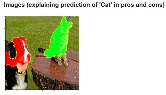

Model interpretability is a hyper-active and hyper-hot area of current research (think of holy grail, or something), which has been brought forward lately not least due to the (often tremendous) success of deep learning models in various tasks; these models are currently only black boxes, and we naturally feel uncomfortable about it...
Here are some general (and recent, as of Dec 2017) resources on the subject:
And on a more practical level (code etc):
Lately, there has been a surge of interest to start building a more theoretical basis for deep learning neural nets. In this context, renowned statistician and compressive sensing pioneer David Donoho has very recently (fall 2017) started offering a course at Stanford, Theories of Deep Learning (STATS 385), with almost all the material available online; it is highly recommended...
