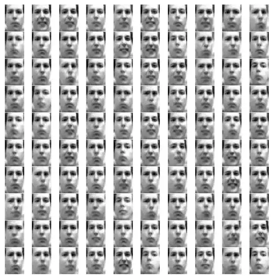

Example:
Source: Stanford University CS231n slides
Assume there is an x_axis and a y_axis on the bottom and the left. Let the x_axis represent $x_1$ and y_axis $x_2$ which are our hidden variables. By varying $x_1$ and $x_2$ you can see what happens. Increasing $x_1$ changes face angle while increasing $x_2$ changes eye droop. Thus we can generate new data by varying the features in a latent representation.
