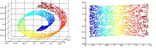

For example, in this "Swiss roll" data, the 3d data on the left is sensibly modelled as a 2d manifold 'embedded' in 3d space. The function mapping the 'latent' 2d data to its 3d representation is the embedding, and the underlying 2d space itself is the latent space (or embedded space):
