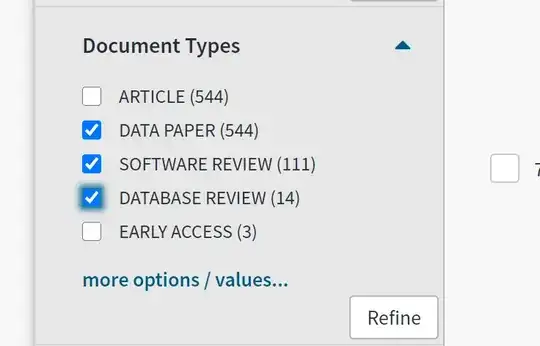

Some bibliographic databases capture such documents with a special category. At Web of Science, for instance, you can refine the results to 'data papers', 'database reviews' or 'software reviews':
Web of Science menu
