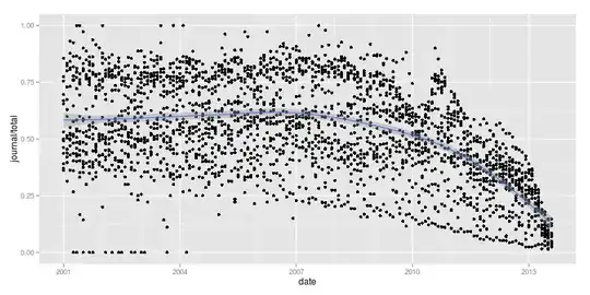

17
It is a lot of work to find out which paper in arXiv has actually the same content as a published paper. However, taking arXiv's journal-ref field as a surrogate indicating which paper has a journal version out, I arrive at these fraction of papers: fraction of arXiv papers with set "journal-ref" field
So it looks as if the gut feeling that this is field-dependent is true: high energy and nuclear physics have consistently high fractions of papers with journal-ref field set. On the other hand, this seems far less common for maths papers. Note that a certain drop at the end is to be expected as the preprints may be uploaded to arXiv considerably before the paper is accepted, printed and the journal-ref is updated in arXiv.
Here's the marginal plot over all fields: fraction of arXiv papers with journal-ref set So overall, about 45% of the papers have a journal-ref. However, it is set for almost 60% of the 2001 - 2007 papers. Whether this is a real decline or just the lag between preprint and paper publishing remains to be seen (in a few years).
Also, neither the overall nor the subject-dependent trends seem to have a convincing increasing trend, even if the decline due to "not yet published and updated" is assumed to be the sole cause of the decreases.
For the complete picture, here's the development of total number of papers: number of papers in arXiv
and number of papers with journal-ref set: number of arXiv papers with journal-ref set

    Thanks for making the effort to process the data and generate these graphs. – Dan C Aug 23 '13 at 03:24
    I guess the drop at the end is in fact mostly the publication delay. This is also field dependent - math journals are known for extraordinary publication delays, and that is very apparent in your plots. – silvado Aug 23 '13 at 08:31
    @silvado: yes I agree. However, I wasn't aware that a delay of 6 years sounds reasonable e.g. for maths. In my field (chemistry/chemometrics) the delay is much shorter, also because we have to be careful whether pre-prints are considered previous publication, so I put my preprints to arXiv only after submission or even after acceptance/end of the embargo time. That makes much shorter to no delay. – cbeleites unhappy with SX Aug 23 '13 at 09:10
  • @silvado: It certainly seems update delay, rather than publication delay. – unsym Aug 24 '13 at 02:29
  • By cutting off the 6 years, there is a clear downtrend for math/math-ph/astro-ph, and stay the same and up for others. It should be due to the difficult of publishing in those journal. To get the better comparison, we must also parse for real published paper and compare the date, which is very hard to do. – unsym Aug 24 '13 at 02:31
  • @cbeleites The tendency in maths to publish preprints very early certainly adds to the observed delay time in your data. – silvado Aug 26 '13 at 07:27
