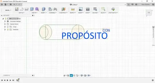

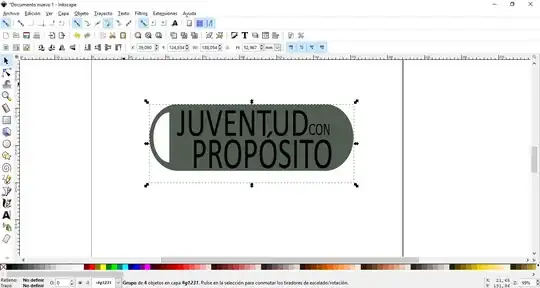

I made a simple logo using Inkscape, after saving as an svg file, but when I export that file into Fusion 360 something strange happened.
Multiple times I convert some images (png, svg) to svg file. The process I use is this:
  1. Scan logo image (scanner or smartphone)
  2. Open image with Inkscape
  3. Using the stroke, generate the shape
  4. All process for generate and save
This process explained above always works for me, when I copy the shape using the stroke in Inkscape.
However, when I was do the process using the shape generator - for example, rectangles, circles, squares, etc. - and export the file into the Fusion 360, it doesn't work.
1 - Inkscape logo
inkscape
2 - Logo import to Fusion 360
Import into Fusion 360
In the example above, the first word does not appear.
