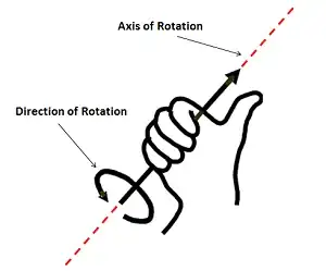

In addition to the other answers, the right-handed designation comes from math and pysics convention that has become a well known mnemonic in engineering practice:
Right hand mnemonic
or in its physics coat,
right hand rule in physics
The Right Hand Rule: Figure (a) shows a disk is rotating counterclockwise when viewed from above. Figure (b) shows the right-hand rule. The direction of angular velocity ω size and angular momentum L are defined to be the direction in which the thumb of your right hand points when you curl your fingers in the direction of the disk’s rotation as shown. reference
In a right-handed extruder,
Right Handed Extruder Setup
you place your thumb of your right hand in the direction of the shaft (so pointing it towards yourself in the image of the extruder above) to see that rotation in the direction of your curved fingers leads to extrusion of filament (in counterclockwise direction).

  • i'm not quite sure why "the right hand rule" should have any meaning here – darth pixel May 14 '19 at 08:35
    @darthpixel because it is a math/physics convention: a rotation is given as the rotational axis and the speed of it. "10° per second around X" means it rotates with that speed counterclockwise around the X-vector. A "lefthanded" extruder spins - mathematically speaking - around the -X vector. – Trish May 14 '19 at 10:54
  • but it's not connected to left or right handed extruder. L, I and omega are also not very needed in terms of the question - What makes an extruder right handed? you could also incluse 2*pi*r as it's also loosely connected but it won't help here. left handed means this and right handed means this - why to make things overcomplicated? rotation direction is not really what defines left/right handed extruder – darth pixel May 14 '19 at 12:14
  • Sorry but it is. Do you think it is called because you operate a right-handed one with your right hand? :) – 0scar May 14 '19 at 12:39
  • :D i claim that pictures in your answer make it even more curly and they are not making the subject clear. the RHR doesn't explain anything here, the thumb doesn't represent anything so this picture is misleading rather than explaining - that's what i think – darth pixel May 14 '19 at 13:23
  • @darthpixel I'll try to find a better picture. The thumb is the "shaft", I'll try to clarify that with an edit! – 0scar May 14 '19 at 13:31
    Righthanded: The shaft of the motor and the rotation vector (According to **right** hand rule!) both point out. Lefthanded: the shaft poinsts out while the rotation vector points in. – Trish May 14 '19 at 13:40
  • @Oscar and Trish please try to imagine a person who is not very familiar with physics - i think such person won't get much from your explanations. What is rotation vector for such person? I'm really trying to imagine the contaxtual meaning of the RHR based on your answers and comments but this still leads me nowhere. and believe me - i'm familiar with physics and at least a bit with 3d printing. – darth pixel May 15 '19 at 04:49

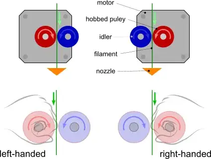

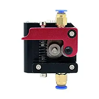

This is an example of a right handed extruder setup:
And this is an example of a left handed extruder setup:
Left Handed Extruder Setup
I believe that you can can choose whatever one you favor. With the right handed setup, you will be pushing down the red part with your right hand when inserting filament. With the left handed setup, you will be doing the same thing but then with your left hand. Personally, I favor the right handed setup (my right hand is my dominant and stronger hand). But, you should be able to choose whatever one you like! Be sure to check it will work with your printer though (extruder holder & hotend).

when thinking about righ-handed extruder or left-handed extruder it's good to know that there is no magic or any other science rule behind this naming convention. it's just an arbitrary explanation which can be unfortunately misleading. in fact there is visual explanation of this left / right handed name and it doesn't have anything to any "the right handed rule" mentioned in other answers.
it's just this
no physics... no magnetism... no induction... no vectors and no formulas

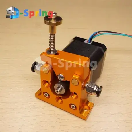

the other answers present pictures of LH and RH extruders which are of course fine but be careful - there are universal extruders which can be both L or R handed.
like this one
as this extruder has fully fixed filament path and there is no restriction which direction the filament should go - there is no way to describe it arbitrarily
it is left-handed when it works as left-handed and it is RH when it works as RH
