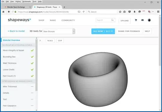

A first thought: Try loading your stl into one of the services that price online. Shapeways does, and Cubify does or did... and you can download the driver software for the Form2 even if you don't own the printer.
Bring your stl into these apps and look for error messages. The Shapeways ordering app does a nice job of showing issues, particularly ones like wall thickness and manifold faces/vertices (another possibility I did not mention above) very quickly.
I'd offer to look at your stl if it is something you can share... and/or you can ask your output guy for a sample stl he has printed with some success before. Bring that stl file into Blender beside your model and compare.

Here's a torus at Shapeways I uploaded....
  • Sorry -- error messages you'd get from a different service might be helpful in diagnosing your issue -- but might not be applicable, either. I was just thinking of ways to confirm your stl file's validity in the wider 3D printing world. –  Apr 13 '16 at 22:17
