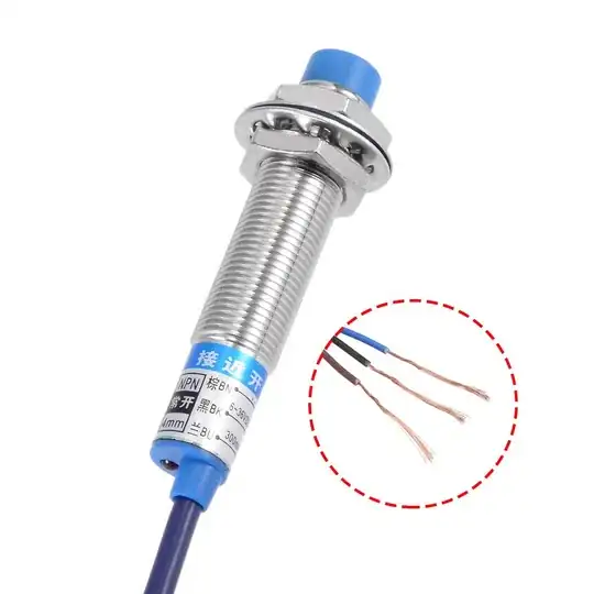

uxcell 4mm Inductive Proximity Approach Sensor Switch Detector NPN NO DC 6-36V 300mA 3-Wire LJ12A3-4-Z/BX

As for the sensor, blue is GND, black is signal (PWM) and brown is power as seen in e.g. this answer.

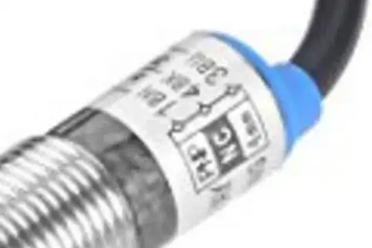

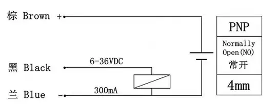

For completion, the sensor's internal schematic is on the side of the sensor itself1:
Sensor schematic
where:
  • PNP - 1 BN - Brown - VSUPPLY
  • N/O - 4 BK - Black - Sensor output
  • 4 mm - 3 BU - Blue - GND

There is a bit more to the schematic, which can be glimpsed here (on the left hand side):
Sensor image#2
