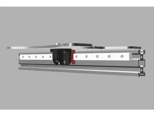

I managed to get rid of the problem by installing a linear rail for the y-axis! enter image description here
Used this mod from thingyverse: https://www.thingiverse.com/thing:3064275
There are also solutions out there which are placing a linear rail on the left AND right side, but since for me the problem was only on the left side, this seemed sufficient (and was).
