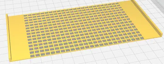

I am trying to print an item with a rectangular grid (using PLA on Ultimaker 2+):
item with a grid
Holes are 4x4 mm, distance between holes (wall thickness): 1mm. I am printing with 0.4 mm nozzle.

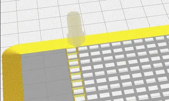

Unfortunately, Ultimaker Cura generates G-code which prints each rectangle on its own and in a quite a bad way:
print preview
The printer head tries to draw a rectangle, then moves in the direction opposite to a last laid line, which with not perfect adhesion of single line messes up the print pretty badly: it often picks up last rectangle side and drags it.
Any way to change the way Ultimaker Cura approaches to lay out the grid? I would imagine that long lines that are connected to other lines would adhere to bed much better than individual squares, but I don't see any options that would allow to alter it.

Slicers never create a grid by crossing the already printed lines - they print perimeters and thicken them into a shell. So if the picture that is to be printed is a #, it does not lay down first the || and then the = crossing over it, it lays down an inner square and then builds the rest to get to the shape. This operation rule is held for shells, but not for infill patterns.
As you describe the printer picking up the printed, you have adhesion problems and your first layer might be not level or too thick.
You might also want to enable "print thin walls" and use 2 or 3 perimeters.

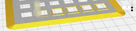

It looks as though you are using an older version of Ultimaker Cura as it only prints one line of each of the small rectangular holes (or are you actually using a single wall/shell), in later versions of Ultimaker Cura this is fixed (e.g. the image below is created with Ultimaker Cura 3.4.1), it will print all walls/shells before commencing to the next small rectangular hole. This way you have more lines deposited which have a possible better adhesion to the increase of laid down material:
Ultimaker Cura showing all laid down perimeters of small holes in a print
Further investigation of your image shows that you are using a very fine grating (< 1 mm?) resulting in very limited amount of walls. In your case the version is not that important, but the latter information is just left as a possibility for people that use an older version of Ultimaker Cura.
