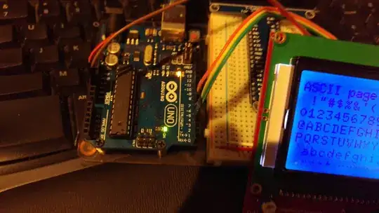

The LCD could be tested separately by creating a sketch in Arduino IDE and connect the correct pins of the LCD cable to some pins of an Arduino device, e.g. load the the U8Glib example sketch "GraphicsTest" and add the following constructor:

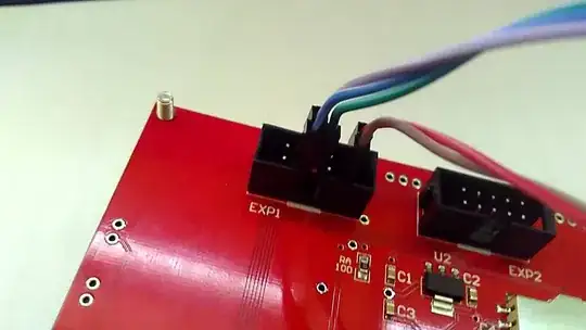

This implies that you need to attach the correct pins on the Arduino (in my case to digital pins 6, 5 and 4 for respectively SCK, MOSI and CS to the respective EXP1 pins 5, 3 and 4):
EXP1 wiring for Arduino Uno
Jumper cable wiring full graphical display for testing purposes
Note that you see 5 pins attached, as the LCD needs to be powered (pin 10 on the EXP1 header) and grounded (pin 9 on the EXP1 header).
RepRapDiscount Full Graphic Smart Controller connected to Arduino Uno clone running U8GLIB "GraphicsTest"
I wired this on an Arduino Uno clone and confirmed that 2 of the spare RepRapDiscount Full Graphic Smart Controller clones showed the test program.
PS, this is a simple wiring of the LCD, it displays the test in fade blue-ish, so not the bright colored white pixels, but that is normal!

    @2012User I have updated the answer with an LCD test and confirmed that it works to test the display. I've tested 2 LCD's to find out that one of the LCD's had the connector shields upside down, so thank you! ;) – 0scar Dec 28 '18 at 13:34
