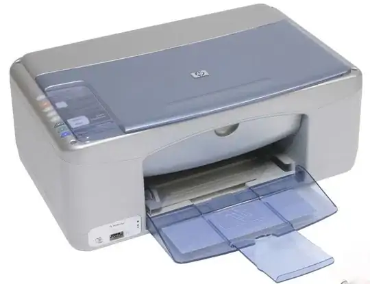

I thought as a fun project to make my own 3D printer out of a normal printer parts + some parts out of old CD-ROM drives that are lying around. The printer of my choice is an HP PSC 1315 one. HP PSC 1315 All-in-One Inkjet Printer
But I have these questions:
  1. Does this printer users stepper motors or is using a combination of DC ones and some sort of position sensor?
  2. What kind of electronics and firmware I can use for this type of builds?

No, Printers are not good sources
Common printers contain at best one stepper motor in the scanner, and it is usually too weak for use as an X or Y stepper, but for a very slow printer they might be useable, especially if you could source 2 or 4 of the same type.
The main motors in the printer are almost universally DC motors that get their turning signal as a voltage from the main board, which again uses positional information from an encoder strip/disk. Using both of these to make a 3D printer is usually not feasible.
However, they usually have good rails (sadly often of non-standard diameter) and might be salvaged for a decent optical sensor. See also Thomas Sanladerer's video about this.

"Yes" you can, but "No" it is not a good idea.
A colleague of me is building a Anet A8 clone from salvaged rods from a bunch of printers he had. The rods are 9 mm in diameter for which you cannot find affordable linear bearings. We printed bearing blocks from PLA with integrated glide surfaces to solve that.
Furthermore, practically nothing of interested can be obtained from a 2D printer/scanner. The steppers are too weak, the belts too flimsy, and the electronics are not useable. Only on optical sensor (used as an endstop), but these literally only cost about $0.40 (then you get the whole module including the cable). Also, linear rods of good quality are best obtained locally from a local (web) supplier, there are mixed experienced with those found on cheap internet auction sites.
Considering the amount of parts that can be salvaged from a 2D printer/scanner, and the part you actually need to order to complete the build, you better spend a few extra bucks and order all parts.
