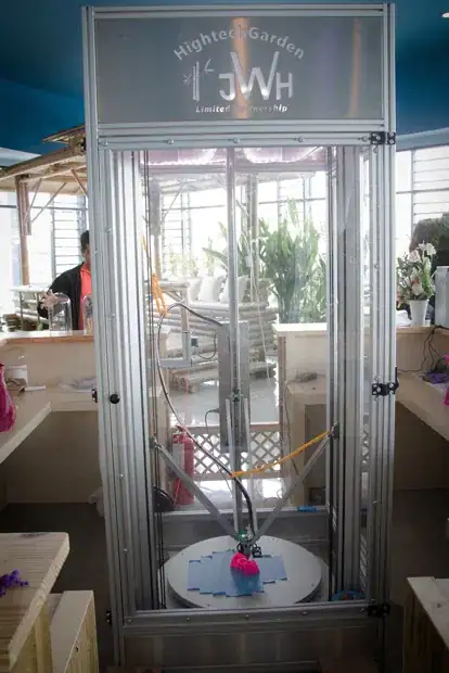

Anecdotally, I visited a 3D Printing shop in Bangkok, JWH High tech Garden, that had a huge Delta printer that had, reputably, cost a million baht (~£20000) if my memory serves me correctly, and was capable of producing prints up to 1000 mm x 600 mm (39.37" x 23.62"):
Large Delta printer

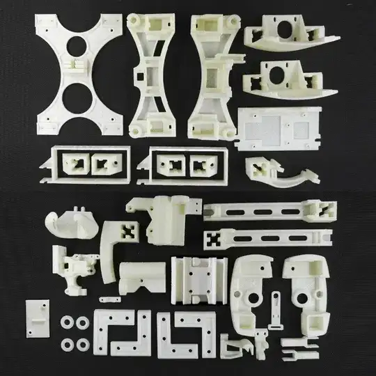

However, the print service was not cheap at all. In May 2017, I was quoted 68000-100000 baht (~£1360-2000) for some printed parts (the proteins) for a Wilson II 3D printer, which are about only £70 on eBay!
Wilson II proteins
