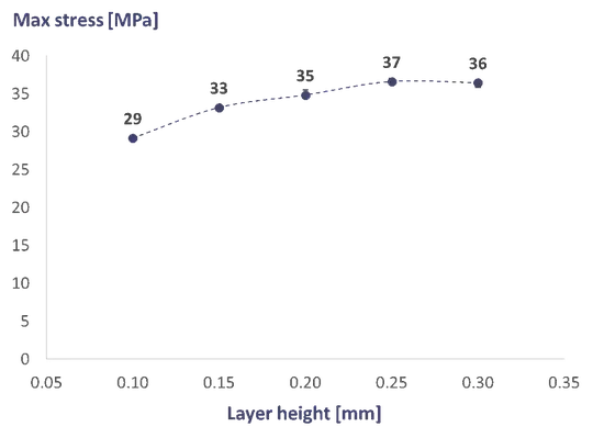

My3dmatter.com performed a series of tests with PLA, using "a universal testing machine". They conclude:
Layer height influences the strength of a printed part when it becomes thin. A printed part at 0.1mm shows a max stress of only 29MPa, as opposed to 35MPa for 0.2mm (21% increase).
Past 0.2mm, the max stress remains fairly constant around 36 MPa (we confirmed this conclusion with an extra test at 0.4mm, not shown here because it was not part of the same batch).
Note: It is recommended to read the full article to comprehend the complexity of the subject matter.

  • @SeanHoulihane Well, the values shows the strength of the whole part taking in count the infill and only one temperature and one speed. The bonding is the strenght adhesion of each layer so this need to be measured like a peel off test.To get the better bonding parameter is necesary to do a Desing of Experiments (DOE) but this expample gives at least the best choice at one temperarure and one speed. Could be opossite with diferents parameters. One day I will do the DOE just to assure the best quality on my prints. – Fernando Baltazar Sep 14 '18 at 19:47

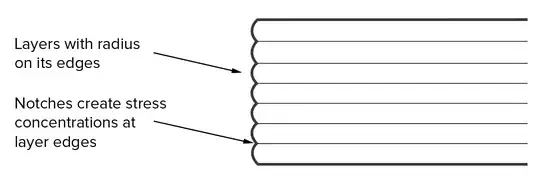

Also, I would not say that poor bonding strength is the cause of failure in Z direction, as FDM deposits layers in between each layer you will have a lot of potential crack initiation locations, this is usually the starting point of the failure. I have seen prints start the failure between the layers, but not continue to crack along the layers, but traversing through the layers meaning that the bonding strength is not that bad after all.
Stress concentrations by FDM process
