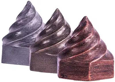

Metal filament
You print with a special filament that contains from mixture of metal and plastic. After the print you heat up the object around 450°C to burn plastic away and melt metal grains together. You need a kiln. DIY kiln is about 150$.
Before kiln process printed object
After kiln process postprocessed
The only filament I know is Filamet from The Virtual Foundry. CopperFill from ColorFabb contains just 30% of metal in oposite to Filamet containing 80%.
Just remember that these filaments are pretty dense which makes 1kg spools quite "shorter" and thus even more expensive!
