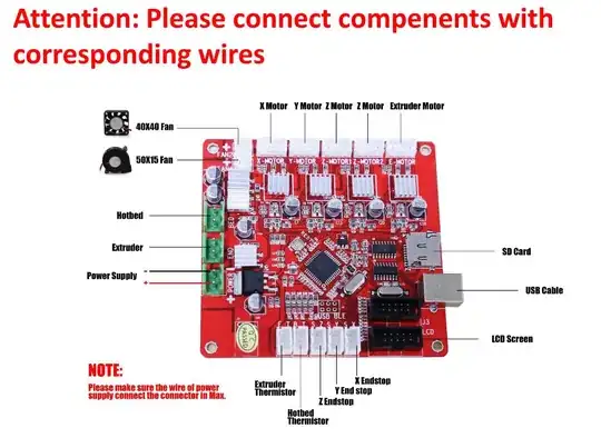

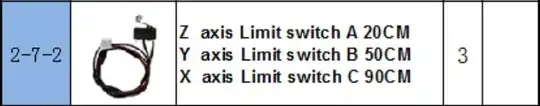

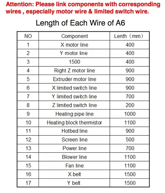

The A6 3D Printer Installation Instruction shows that there is an endstop, part 2-7-2, page 4, included in the kit:
Limit switches
It needs to be fitted as shown on page 8:
Image showing Z-axis minimum stop
Page 36 shows the correct length of the wires, which should prevent the wires being pulled out of the sensors/switches:
Wire lengths
Page 38 shows where the Z-axis endstop is attached to the controller board:
Controller board connections
To be fair, this assembly guide seems to be rather poor quality and after having looked through it a number of times I fail to see any actual instructions on how, or where exactly, to mount the Z-axis minimum endstop.
