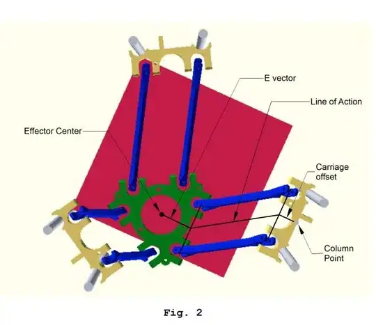

There are two main special steps to the technique used by most open-source 3d printer controllers:
  1. Divide each linear gcode segment into lots of very small subsegments ("Segmentation")
  2. Use some basic trigonometry or the pythagorean theorem to tie extruder position to carriage height for each of the three towers ("Inverse Kinematics") to find the target position for each small segment
The inverse kinematics are surprisingly simple. A virtual 90 degree triangle is constructed from two known lengths to solve for the unknown third length:
  • The fixed delta arm length is the hypotenuse of the triangle
  • The horizontal distance between the column joints and end-effector joints is calculated from the XY coordinates of the nozzle and the fixed position of the column, to determine the length of the lower side of the triangle
  • The length of the upper side of the triangle is calculated from the previous two via the pythagorean theorem
  • The length of the upper side is added to the nozzle Z height to get the necessary carriage height
I think the best open-source reference here is Steve Grave's Rostock Kinematics document, rev3 available for download here: https://groups.google.com/d/msg/deltabot/V6ATBdT43eU/jEORG_l3dTEJ Some relevant pictures: enter image description here enter image description here
These inverse kinematics calculations are performed for each carriage to get a "carriage space" target position, and this is performed for every path sub-segment.
The results from these steps can then be reinserted back into the standard linear path interpolation techniques for the printer, in which it fires steps in the necessary ratios and at the necessary rates to produce the desired straight-line motion and acceleration/velocity profile. (How THAT is done is a different question.)
