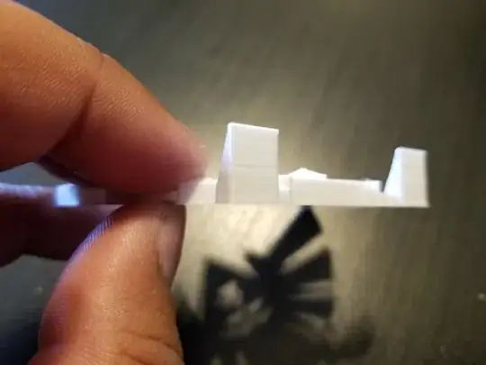

I tried switching back to a known good filament and found that I couldn't get anything to extrude anymore. After researching a bit online I suspected that there may be an issue with a clogged nozzle, so I did a couple of cold pulls and then tried one of my known good filaments again. This time I was able to extrude and print out a full test without issue.
After that I switched to one of the HTPLAs and it started printing. I thought all was good, but during the course of the test print the nozzle clogged again and stoped extruding.

After I switched back to inland filament (which had been working fine for months) I was still having extrusion issues. At this point it was due to the clog (I suspect).
I tried several steps to unclog the nozzle including the steps suggested by prusa support and cleaning techniques suggested by Tom amongst other places.
I also picked up a couple of pencil brushes on amazon including a small brass brush that's perfect for cleaning off the extruder pulley teeth.
Cold pulls
During these steps, I think I introduces the second problem without being aware of it. I perform a bunch of cold pulls (explained by Tom in his video and other videos and posts). During one of these cold pulls I forgot to loosen the MK3's idler pulley door before tugging. Once I noticed it I loosened the door, but I think that tug may have affected the idler pully getting it a bit gritty (I don't know how it would have done that, but it's my current guess).
At this point I was still getting extrusion issues and didn't think about the idler pulley being the issue, so thinking that the nozzle was still the issue I ordered a second E3D nozzle and some Ethyl Acetate which dissolves PLA.

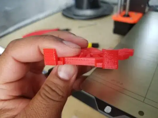

Once the nozzle and ethyl acetate came in I pulled off the old nozzle, dropped it into the ethyl acetate to soak, put the new nozzle on (per the instructions from prusa's website), and reaccelerated the printer just to be safe. I tried printing a test block and it seemed better, so I then tried a larger print and while the printed model seemed better, it was still obviously having extrusion issues and crumpled in my hand.
With the nozzle ruled out, I started looking elsewhere on the printer. After watching a video from the 3D Printing Nerd on extrusion issues he was having on his MK3 I decided to check the extruder pulleys. When I tried to open my extruder idler pulley door I noticed I couldn't actually get it open; it seemed to be stuck on the bottom. I tried to free the bottom of the door, but couldn't without forcing it past my comfort level. Instead, I unscrewed the top of the pulley door to remove it.
From here I noticed two things, I didn't get the pulley teeth as clean as I though I had before and the idler pulley's mounting rod was extended just a bit (which is what was causing it to stick at the bottom). I adjusted the rod and put the door back on. It was printing better but still had extrusion issues.
I then watched the pulley during the filament loading and notices that while the extruder stepper motor was turning smooth, the idler pulley was stuttering a bit while turning. I imagine those little stops and starts were what was causing the extrusion issue.
I opened the idler door back up and worked the idler pulley a bit with my finger. It started to spin free (maybe there was gunk in it? maybe it was rubbing a bit against the mount? ¯\_(ツ)_/¯), so I closed the door and screwed it back in tight.

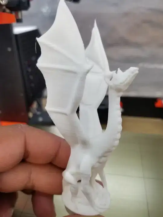

Ran a test print -> perfect.
I've run several prints increasing in complexity and it seems like I'm back to printing well.
