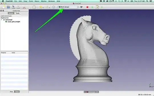

Step 2: Import Your STL File
  • Open FreeCAD.
  • Create a new file (File menu > New).
  • Import your STL file (File menu > Import > select your STL file).
  • From the dropdown menu in the top toolbar, choose Mesh design (see screenshot).
FreeCAD1 mesh design
(Credit: OpenSCAD Chess by Tim Edwards)

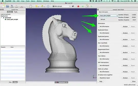

Step 3: Repair the Mesh
  • Open the Evaluate & Repair mesh tool (Meshes menu > Analyze > Evaluate & Repair mesh).
  • Select the mesh from the dropdown at the top of the Evaluate & Repair pane.
  • One by one, go down the list, clicking Analyze and then Repair if the analysis finds any problems.
  • If clicking the Repair button for "Folds on Surface" makes your mesh look terrible, you can skip that one.
  • If clicking the Repair button for any other option makes your mesh look terrible, you’re likely out of luck. However, you should still try the next steps in case you get lucky.
FreeCAD2 analyze repair

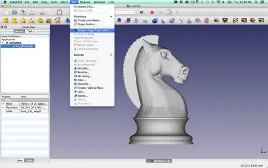

Step 4: Convert Your Mesh to a Shape
  • From the toolbar dropdown menu, choose Part.
  • Select your mesh in the left pane.
  • From the Part menu, choose "Convert to shape."
  • Leave the Sewing Tolerance at 0.10 and click OK.
FreeCAD4

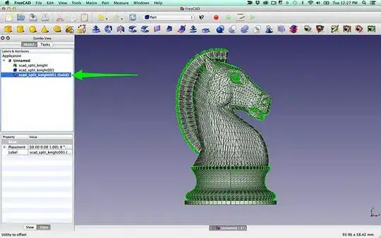

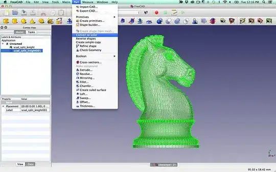

Step 5: Convert the Shape to a Solid
This is the moment of truth! If FreeCAD is able to convert the shape to a solid, you’ll be able to save it as a STEP file. If you get a red error message in the bottom left corner of the screen, you’re out of luck.
  • Select the newly created shape.
  • From the Part menu, choose "Convert to solid."
  • If it works, you’ll see a new item in the list in the left pane that ends in "(Solid)."
FreeCAD5 convert to solid
FreeCAD6 done
