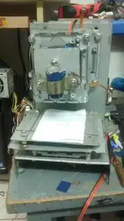

I'm trying to create a 3D printer based on this instructable, EWaste 60$ 3DPrinter.
I have followed the steps provided there, and I'm facing the problem that the x-axis isn't able to move, i.e. the motor works fine but the z-axis part which is connected to x-axis doesn't move left and right. I have tried the following already:
  1. Changed the design of 3d printer by attaching x-axis with y-axis and leaving z-axis separately
  2. I gave a little force to the z-axis part and it starts to move left and right.
Any help on this would be appreciated!

  • The z-axis shouldn't be connected to another axis. I've linked an image below for reference, but X/Y are your planar axes, and Z is your vertical (3rd dimension) axis. https://revolution3dprinters.zendesk.com/hc/en-us/article_attachments/210571428/XYZ_Axis_Movement_Control_Diagram.png – Jesse Williams Nov 09 '17 at 17:32
  • But I am making an e-waste 3d printer..which it told to connect z axis with x axis..you can check the instructable.. I have provided the link in question. And thanks..if u got any idea..please let me know that – Dev MIT Nov 09 '17 at 17:35
    I looked over the instructable. I misunderstood what you were saying. It sounds like you z-axis stepper controller doesn’t have enough power. I don’t understand what you mean about attaching the X and Y axes if Y is driven at the base of the machine. I think this is where my confusion comes in. – Jesse Williams Nov 09 '17 at 17:48
  • In the instructable they mentioned to mount z axis in x axis so that x axis will move z axis left and right and z axis will. Move up and down – Dev MIT Nov 10 '17 at 00:19
  • May be you should check this which was based on the same tutorial, https://www.youtube.com/watch?v=tBFT_aXTuks – Stranger Nov 10 '17 at 12:28
  • With the provided photos it is impossible to even guess how the design is supposed to work. Please provide much more information as otherwise, this is not answerable. – Trish Oct 23 '18 at 09:32

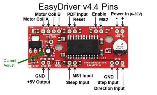

I would suggest removing the Z-axis from the X-axis CD carriage, in order to reduce the mass and therefore the power required to move it, and test the X-axis in isolation. If it moves left and right correctly, then it is not dead (obviously). If it does not move, then try adjusting (increasing) the current to the stepper motor, by adjusting the EasyDriver (assuming that you are using an EasyDriver stepper motor controller):
EasyDriver current adjust
If it still does not move, then replace the stepper (or the whole X-axis CD-ROM drive, which is probably easier).
Then replace the Z-axis and test the X-axis movement again. If it does not move then the stepper does not have sufficient power, or strength, to move the mass of the Z-axis and, again, will probably require increasing the current to it, by adjusting the EasyDriver (as above):
