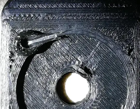

See the image below, captured after the power went off during a print. Heated the extruder, and did Z -10, got this. Both x and Y moved, but in about a 10:1 ratio. The length of the track is about 10mm. Interestingly, during this movement, there was no Z movement.
Movement frozen into print
