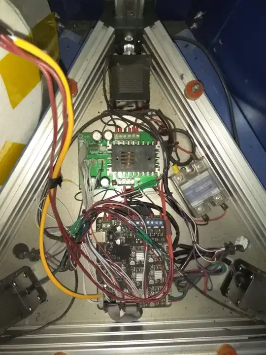

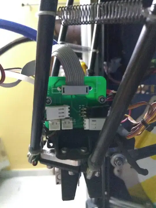

Edit: To be more comprehensive, I'm including pictures of the controller boards.
Main controller board
Hot-end PCB
Also, I've traced the printer down to a Taiwanese manufacturer: http://d-force.tw/
There are a few parts available: Hot-end PCB, Main controller board & Servo motor for calibration (Z-probe). I haven't been able to find the other board (with the HRD12008 SMPS on it and placed just beside the main controller board), yet.
Does this change things? If yes then how?
