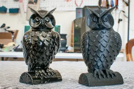

enter image description here The left has been smoothed by an acetone bath and the right is the original model. (Image credit: Andrew Sink)

    +1 - However... Even though the model on the left looks "nicer" and "more shiny", it should be noted that some of the original detail appears to be lost, (obviously) due to the dissolving process. – Greenonline May 21 '17 at 15:06
