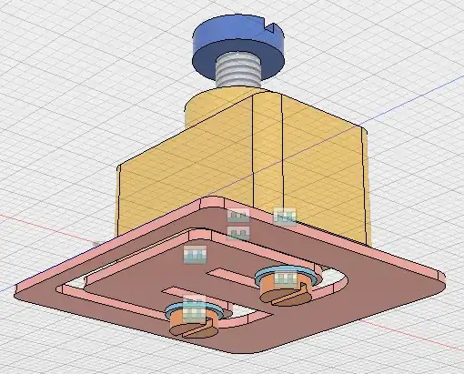

I am creating a 3D printed part which will act as an attachment between a plate (actually a strain gauge) with two M2.5 bolts and a 2kg load with a single M4 bolt. I wouldn't be happy with tapping a screw thread into the print itself so I want to try embedding the nuts into the print itself - so I'll pause the print at the right layer and then insert the nut and, hopefully, the print will resume.
I'm wondering is it worth also including washers? It's a major pain because, while a nut can be captive in a hex space, a washer is circular. So it needs to be glued down on insertion in case it rotates while the printer is printing on top of it.
For a 2kg load I don't believe the nut will attempt to pull through the part but there isn't a whole lot of support between the bore hole and the edge of an M2.5 nut though, only about 1mm.
Edit: I'll add an image of my initial design. The strain gauge is one of a set pulled out of a weighing scales (from Lidl, €5.99. You can buy each separately on the internet for 20 euro, so I saved 74 euro!). The gauge itself is mounted on the narrow "neck" of the gauge. The whole block will drop into a holder that grabs the outer edge of the gauge.

  • I thought it would be useful to add an image of my design (very slowly, thanks to Fusion 360 deciding *right now* was a good time to update itself!). I did a small test with an M3 bolt and nut. If, as you say, the shells and infill are adequate, I don't need a washer. I just need the hole tolerance to be tight enough that the nut won't slip into the hole. So an M3 bolt needs a 3.2mm hole (as printed) - I tried and I can't even begin to pull it through (by hand at least). As my load is 4kg max I think I can do without. Interestingly, I can flex the ABS at 4mm so that's suddenly more important! – carveone Apr 21 '17 at 12:20
  • @carveone it probably depends on your design more than anything else. My experience suggests that it's workable in many cases. My feeling from looking at your design is that it would work fine for the yellow part, and that the red part will have more trouble with the flat parts deforming than with the bolts coming out. – fectin Apr 21 '17 at 17:44
  • Luckily the red part is the metal strain gauge itself and deforming is what I'd like it do ;-) – carveone Apr 23 '17 at 15:09
