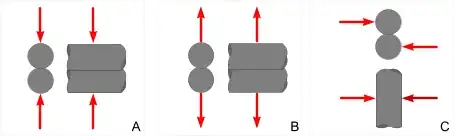

Let's look at these figures:
in figure A we have the strongest composition for compression; this is because all working forces try to damage material particles which is of course hard to do (depending on material density and length of polymers and the way they are tangled and so on - in general - material strength only).
If we consider figure B where forces try to tear apart layers then we know that we base on stickiness between layers which can vary on printing parameters (as is temperature and speed).
Finally, figure C shows shearing forces - in terms of layered structure it doesn't really differ from tearing apart but the results (the resistance of and object) is even weaker - it's because we base on stickiness and we additionally have less effective field of working stickiness) which reduces endurance of an object.
