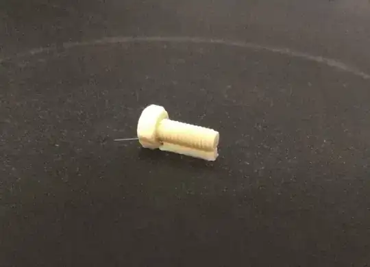

well... it's hard to imagine printing M3 or even M4 I haven't try but I haven't because I'm pretty sure it's not possible (on my printer of course)
but some time ago I've tried M8 which is of course way from your needs it was printed on 0.1mm layer height
it went ok into the nut without any problems but the strength is not very high I suppose
I know the quality is poor but even such bad photo shows issues

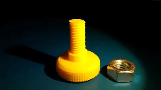

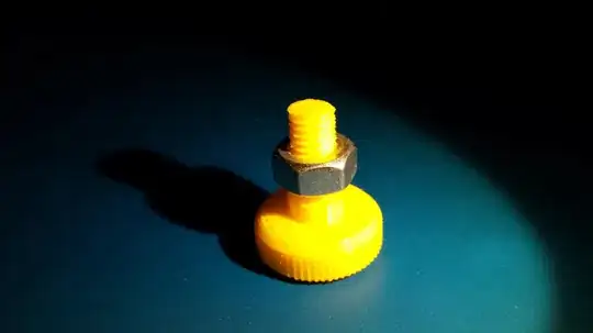

Yes. This question and most of the answers are old, and 3D printing has come a long way in the past 4 years or so. Alexandre Strube's bumping with one up-to-date answer inspired me to take another try at it, and my first attempt was an overwhelming success.
  • Bolt printed in horizontal orientation (with support), nut vertical.
  • Wall line width reduced from 0.4 mm to 0.3 mm (still 0.4 mm nozzle) - most important for the bolt or the thread profile is not achievable.
  • Layer height 0.12 for bolt, 0.08 for nut (to give nearly 10 layer per revolution)
  • Both offset 0.045 mm from ideal thread profile (at M6-M8 this is about the maximum allowable by ISO standard; at M4 it's surely excess but extrusion roundness of FDM probably compensates entirely anyway).
  • 100% infill, achieved with high wall line count rather than zigzag fill
The nut and bolt fit tightly but can be turned by hand (if your fingers are small enough) with some force.
bolt on bed with support
nut and bolt threaded together
These were printed in cheap PLA on an Ender 3 with entirely stock hardware, but upgraded controller board (SKR mini E3 V2.0) and firmware (presently using Klipper).
As for whether they're usable, My Tech Fun has a video testing the strength of 3D-printed bolts in different orientations. His tests were of M10, but the horizontally-printed one was able to hold over 140 kg in a pulling test, making it (especially with multiple bolts) suitable for serious applications.

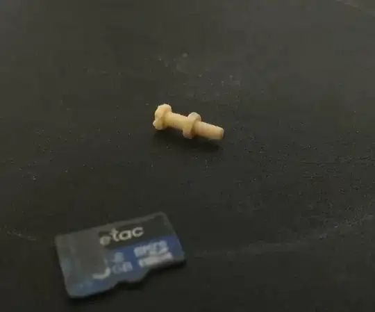

Since the question mentioned M3, I went back later and figured I'd go even smaller and give M2.5 a try... and it worked! This is pretty surprising considering the pitch is just over the nozzle size, but with 0.2 mm extrusion widths and 0.08 mm layers it came out usable:
M2.5 nut and bolt with micro sd card for scale
  • That looks nowhere near as good as with a properly sized nozzle for the extrusion widths, I believe the "extrusion width < nozzle diameter --> inaccurate flow" still stands. – towe Dec 04 '20 at 07:10
    @towe: which part are you talking about? I had an error in priming setup when I did these that messed up the heads a bit. – R.. GitHub STOP HELPING ICE Dec 11 '20 at 04:16

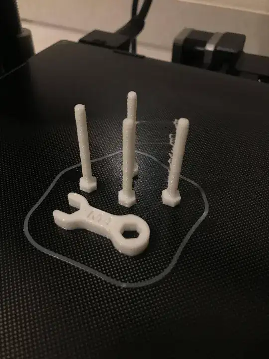

I just did.
I printed a 4 screws at .2mm and 20% infill. surprisingly, all screws worked with a plastic m4 nut I had from china (not 3d printed). The project itself 1 tells to print at 100% and 0.1.
When I started screwing the 4th one, I pushed the tool badly, and the screw head popped off.
After reading this thread, and experiencing what I just said above about the screw's head, I'm printing one more, this time at the maximum resolution and maximum infill. I'm also printing a nut to compare to this.
Even the ones with plastic flying around them worked well (see picture).
1 https://www.thingiverse.com/thing:2591857
Ps: apparently the person can't make hexagons. I will redo the heads in proper hexagons, as well as the little wrench when I have time.
  • It looks like you were bit by Cura's bad default *Maximum Retraction Count* and *Minimum Extrusion Distance Window* causing skipped retractions. Setting the window to 0 fixes it. – R.. GitHub STOP HELPING ICE Oct 26 '20 at 23:45
  • At 0.2 mm layer height it's really surprising these work at all. Assuming M4x0.7, that's only 3.5 layers per revolution of the thread, and the thread is almost certainly wide enough (just due to layer height) to be out-of-spec. Normally you want at least 5-6 and preferably 8-10 layers per revolution (e.g. at most 0.2 and preferably 0.12 for M8x1.25). If you're getting by with less it's probably a matter of non-rigidity of the bolt and nut; with a metal nut, threading it on might actually cut a fix in your print. However.. – R.. GitHub STOP HELPING ICE Oct 26 '20 at 23:51
  • ..it's nice that you bumped this question! Things have changed a lot since 2016, and it's nice to see how something everyone thought was impossible then is actually doable now, even on a $200 printer. When I saw this bumped, before reading your answer, I took it as a challenge to print some, and I might still do that. – R.. GitHub STOP HELPING ICE Oct 26 '20 at 23:53
