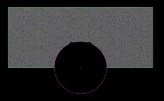

You could modify it as shown in my picture. I added lines tangent to the 11mm circle and in this example I set them to a 40 degree overhang which should be fine, the top line is also tangent to the circle and in my experience it's easier to bridge a small section rather than do a bunch of small overhangs like an arc would do. You still end up with quite a bit of contact but also easy to print.
I did something similar to this on my printer where the smooth rods enter horizontal holes.
Angled Overhang

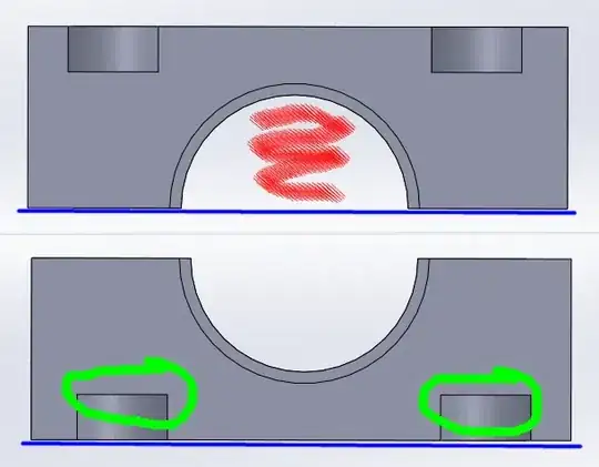

if I printed it in a different orientation it would delaminate too easily
If you flip it around, the orientation of the layers would be the same, except that you would print from top to bottom instead of bottom to top.
With the arch opening to the top, there would be no overhang. Without overhang, you don't need support structures (red). The holes for screw heads have flat roofs (green) that the printer should be able to gap by moving over them quickly.
Here's an image that shows the original orientation at the top and my proposed flipped orientation at the bottom. The blue lien is the print bed. both orientations
