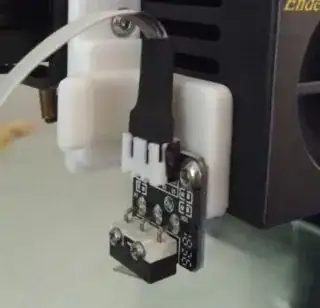

I just discovered automatic bed leveling (ABL) probes that only use a microswitch.
For example, the FreeABL as shown below:
Photo of a FreeABL installed on an Ender 3
Source: Thingiverse.com
