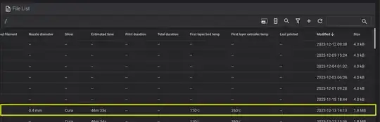

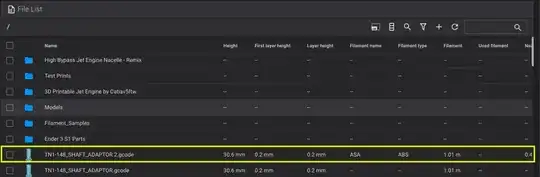

I've been using Klipper and Cura for a while now (somewhat new to 3D printing), and I notice whenever I import a new G-code file to Klipper, none of the Slicer settings from Cura display in the G-code files in Klipper. However, when I imported a G-code file from my friend (the PETG one) I noticed it showed up right away:

Update (Answer... Kinda)
So after looking into the Moonraker python, I can see that there actually is a Cura class that extends BaseSlicer
class, and it's what handles the comment parsing:
class Cura(BaseSlicer):
def check_identity(self, data: str) -> Optional[Dict[str, str]]:
match = re.search(r"Cura_SteamEngine\s(.*)", data)
if match:
return {
'slicer': "Cura",
'slicer_version': match.group(1)
return None
# .. Truncated some rows..
def has_objects(self) -> bool:
return self._check_has_objects(self.header_data, r"\n;MESH:")
def parse_filament_weight_total(self) -> Optional[float]:
return regex_find_float(r";Filament\sweight\s=\s.(%F).", self.header_data)
def parse_filament_type(self) -> Optional[str]:
return regex_find_string(r";Filament\stype\s=\s(%S)", self.header_data)
def parse_filament_name(self) -> Optional[str]:
return regex_find_string(r";Filament\sname\s=\s(%S)", self.header_data)
def parse_nozzle_diameter(self) -> Optional[float]:
return regex_find_float(r";Nozzle\sdiameter\s=\s(%F)", self.header_data)
And if you look at the regex, it's looking for some config names like Filament weight, Filament name, Filament type, etc. But Cura stores it as just name, weight, and type, but puts it under a [metadata]
section.
Also, the Cura-style metadata is all just concatenated into one string, which has a line return injected every 80 characters. This means that depending on the values, some of the names of the metadata items get truncated halfway through, and have another ;SETTING_3
injected as the prefix, which makes it somewhat of a nightmare to simply parse with RegEx.
I was trying to avoid having to modify any Moonraker code, but it looks like I'll just have to alter the Cura class to extract all lines that start with ;SETTING_3
, then concatenate > JSON Parse > INI Parse.
