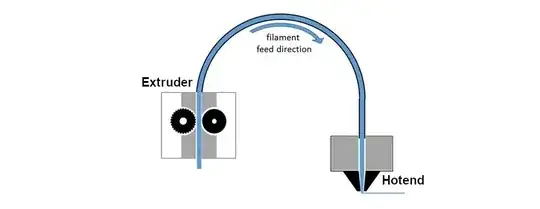

Bowden extruder
A Bowden extruder has the motor located remotely from the hotend, usually on the printer's frame. Filament is fed from the motor to the hotend through a Bowden tube. This setup is typically used in 3D printers that require high speeds and accelerations, as the reduced weight of the hotend allows for faster and more accurate movement.
The main advantage of a Bowden extruder is that it reduces the weight of the printhead. It can improve print speed and accuracy, especially for faster print speeds. It also reduces the amount of space required in the printhead, allowing for larger hotends or additional features to be added.
However, Bowden extruders can suffer from problems with filament control, such as oozing or stringing of the filament. The friction in the Bowden tube and distance between the extruder and the hotend causes the reaction time of each motor movement to be extended.

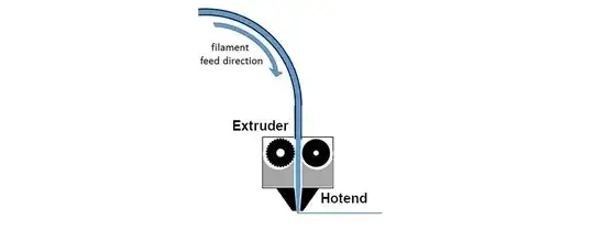

Direct drive extruder
A direct drive extruder has the motor located directly above or beside the hotend, which eliminates the need for a Bowden tube. The Bowden tube is typically very short or totally absent. This setup is used in printers that require precise filament control and are capable of printing with a wide range of materials.
The main advantage of a direct drive extruder system is that it minimizes the distance between the extruder and the hotend. It allows for better control of the filament and reduces friction due to a shorter distance between the extruder and the hotend. This allows to use smaller values of retraction settings, which can reduce stringing and oozing. It results in better control of demanding filaments. Direct drive extruders can handle flexible and soft filaments more effectively.
However, the added weight of the extruder motor can result in slower printing speeds and reduced accuracy during high-speed printing. A heavier printhead can also cause artifacts and ringing on the surface of the prints.
