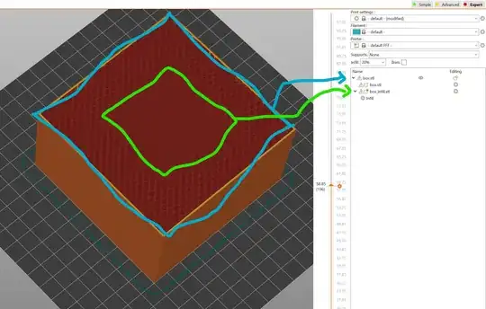

So worked out you can't directly do this with metadata, however you can add modifiers to objects in PrusaSlicer, and you can use external STLs as the geometry for the modifier. Then you can add an infill property to the modifier and set different parameters there.
