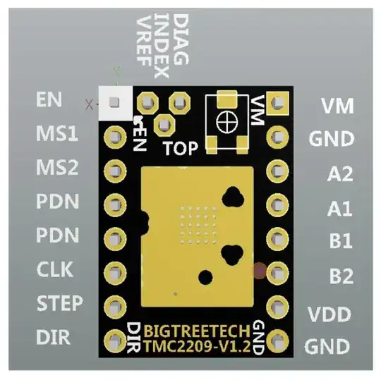

I haven't started on the hardware for this project yet as I'm still waiting for delivery, but I would just like to sense-check my current software mods and hardware plans to see if I'm along the right lines. I am going to take the BIGTREETECH SKR mini E3 V3.0 board and add a 5th stepper driver to get independent control of the Z axes on my printer. Having studied the pins on the board and the schematics of the various ICs, my plan is to connect the TMC2209 to some spare pins on the board.
Using the BIGTREETECH PCB version of the driver:
Diagram of the BIGTREETECH SKR mini E3 PCB
I plan to attach the enable pin to PD0 on the SKR, MS1, and MS2 to ground, UART Tx/Rx to the first PDN as detailed in the manual, VM to the power supply, GND to the power supply, A2/A1/B1/B2 to the motor, VDD to a 3.3V pin from the SPI 1 block of pins on the SKR, and GND to ground.
I think this makes sense as the driver runs in UART mode - it is set to 0x0 by tying MS1 and MS2 to ground - and my present understanding is that in UART mode the CLK, STP, and DIR pins are not needed. I am not 100% on that point so I could be wrong there. If I do need to add it then STP and DIR are easy, CLK would be a bit more challenging but I believe UART does not require a clock signal.

In summary, my main questions are: do I need the CLK, STP, and DIR pins (maybe just STP and DIR?), and does using MSerial1 correspond to the Rx1 and Tx1 pins?

I have the same idea on the same board, but I think to stay with the DIR/STEP mode first. The CLK is useless for the DIR/STEP mode, then I suppose that it is useful for UART mode. But this datasheet is very strange, often there is Rx and Tx UART close to STEP pin STM2209 wiring
When I read the Bigtreetech documentation from your link, only one wire is used for the UART (Rx/Tx). This is strange, or it is to be compatible with other driver and the CLK is useless.
