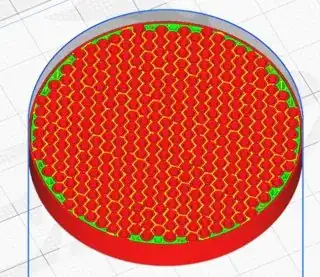

You are printing a model that has a highly complex structure there, with about 650ish holes, assuming there is space for about 2 perimeters between each hole.
imitated design of a cylinder with ca 650 thin holes
Taking my standard 0.3 mm layer height and 0.4 mm nozzle using a 0.45 mm wide line, I sliced a 10mm high slice of the model for a first estimate of the expected print time - and came out with 2:21 hours. That means the expected print time with 0.3 mm layer height is in the area of 47 hours - or just about 2 days.
As a result, 5 days and 5 hours are in the order I'd expect from a 0.1 mm layer height print for the same nozzle, in fact, your settings seem to have a faster print speed than I do work with.
In general, I don't think this model is good for FDM printing at all, due to many non-fully formed lines inside the model (yellow) and the red perimeters being a very dense pattern.
Sliced cross-section: in yellow: many extra thin lines!
