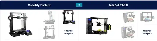

    The mount is for a LulzBot TAZ 5 printer, not an Ender 3. It would be an addition to the question if you expressed why you are using the LulzBot TAZ 5 mount on the Ender 3 to prevent answers that you are using the incorrect printer part. Unless that is actually the issue. – 0scar Nov 11 '21 at 20:12
Unless the question is updated why a LulzBot TAZ printer part is used on the Ender 3, it is unclear why you would want to use the parts from the linked Thingiverse source; quote:
These are the parts needed to mount a Trianglelab Matrix extruder to a Taz 5 and Workhorse.
The LulzBot concept uses the linear rods concept (Prusa i3 style) for the X-axis while the Ender 3 uses a wheel based carriage running on a 2020 aluminium extrusion profile. For comparison, see the image below to show the differences between the Ender 3 and the TAZ:
A specific mount for the Ender 3 is found here.
