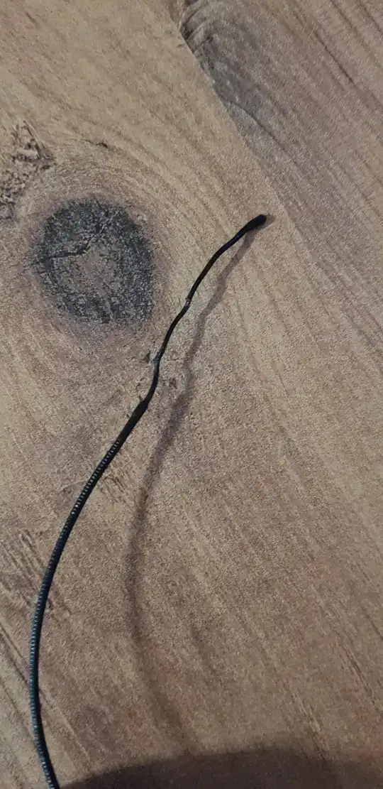

  3. The issue: While the first layer is printing, the filament bunches up around the nozzle and if it somehow touches the bed (like I reduce the Probe-Z offset) it doesn't stick and drags on a few mm. It eventually sticks and keeps printing fine for long straight lines but it's impossible to print a little circle inside, for example. The small details aren't printed on the bed, the filament just bunches up around the nozzle.
    Also when I do a cold pull(heat up to 200 °C then pull at 90 °C, the tip of the filament looks like this:
    Image of the tip of the filament

My theory is that the heat traveling up the cold block thins out the filament, causing under extrusion. The filament can't properly stick to the bed because it's too thin. But the hot end fan works. Should I still replace it?
Or is my problem something completely different?

This sounds like nothing but a bed leveling (distance from nozzle to bed) problem, though you may have introduced other problems disassembling the hotend. It's normal to have material oozing and bunching up before the print starts; this is why you start printing with a priming line or skirt.
Clean the bed well with isopropyl alcohol, level it (paper method at Z=0 or feeler gauges at Z=0.1, I prefer the latter), then fine tune with a leveling test print. If you're still having problems make sure the PTFE tube is tensioned against the nozzle right inside the hotend. Having any gap will make for all sorts of problems.
